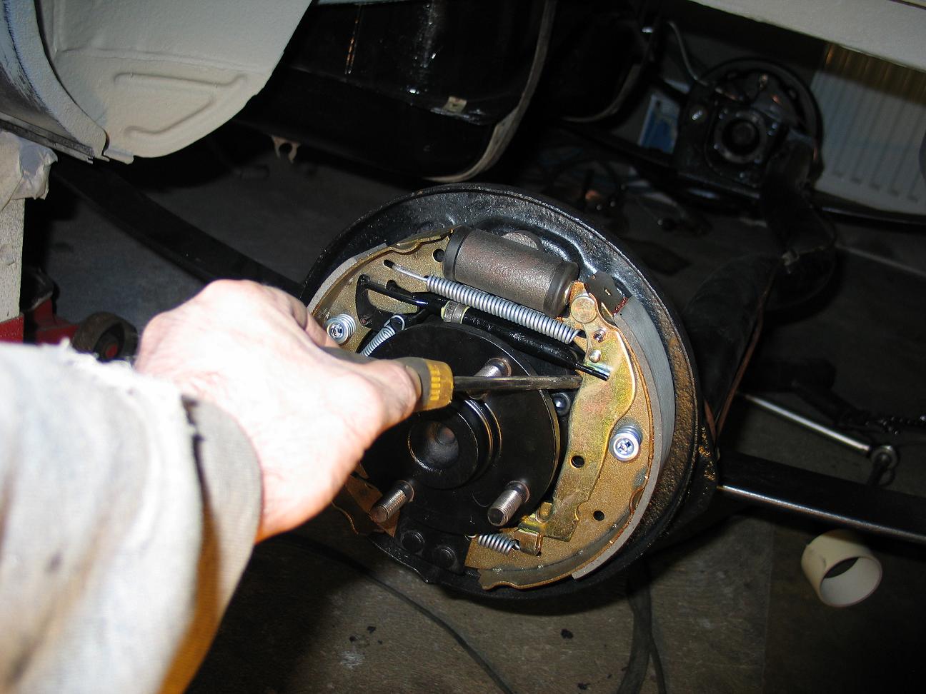

Spot the difference.
Note the screwdriver is used to test the adjuster is working properly. The adjuster ratchet should rotate when the screwdriver is levered sideways. Rotate it by hand/pointy thing to screw it back down.
