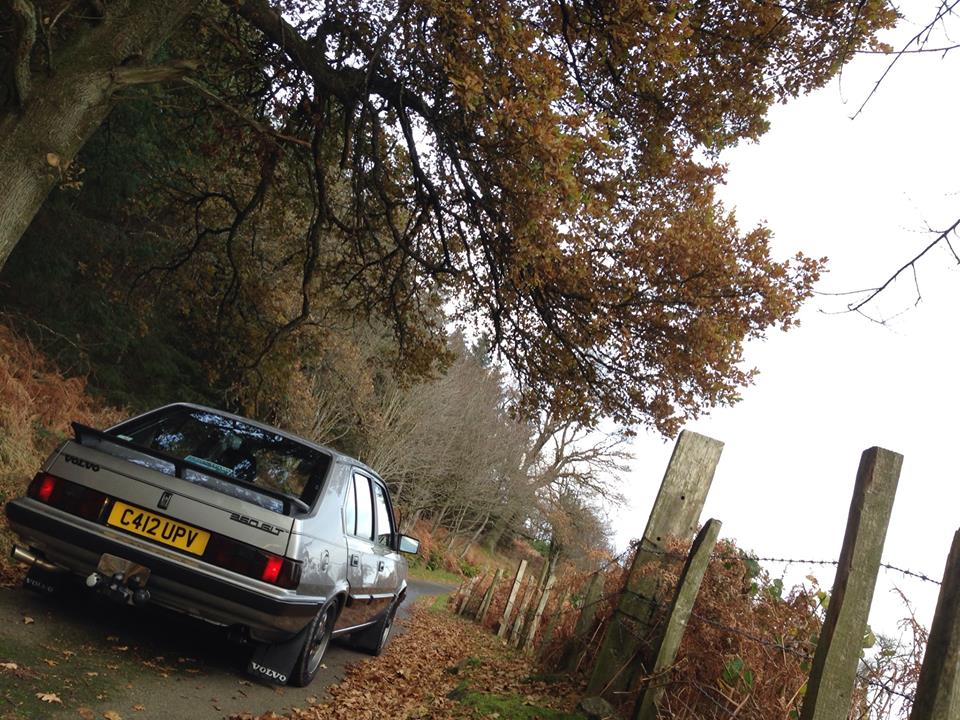

The manifolds are my ones. Your car is white with power steering iirc

nope non pas, only purchased the car last week so just trying to get some ideas atm and do some research, all modifications will be done/bought as and when I have money.

Nice car! That used to be mine! about 2yrs ago! Looking forward to seeing your plans!
