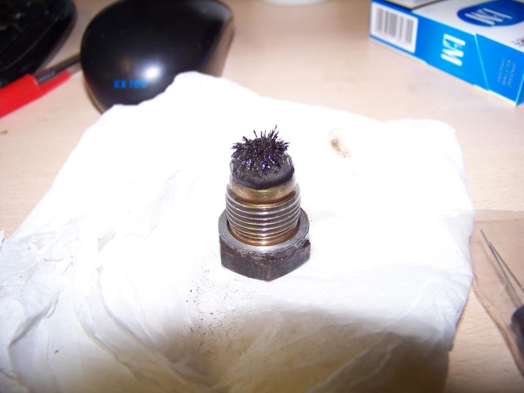

It only took me 6 bloody hours. Granted, it's the first time I removed a gearbox and I was on my own but bloody hell. What a kerfuffle. There is a bit of swarf on the magnet but nothing more in the oil. I swirled the magnet through it after cleaning it and it came out clean. Should I be concerned about this?

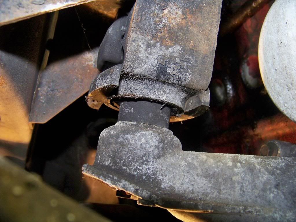

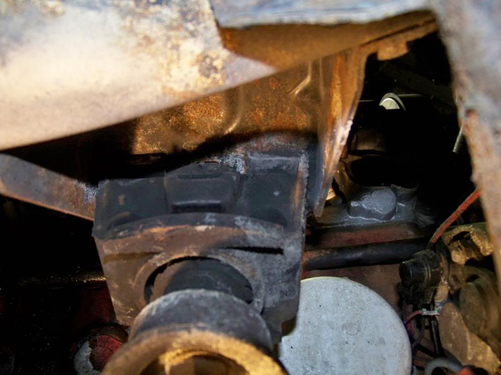

Ok, I need a bit of advice. I have removed the torque tube, there is a bit of vibration coming from the center, is this normal? I was under the impression the prop should be held rigid by the 3 bearings? The main reason I'm doing this is to get to the vibration that I thought was the clutch release bearing. A rumbling noise in neutral when the clutch is let out.
Many thanks.

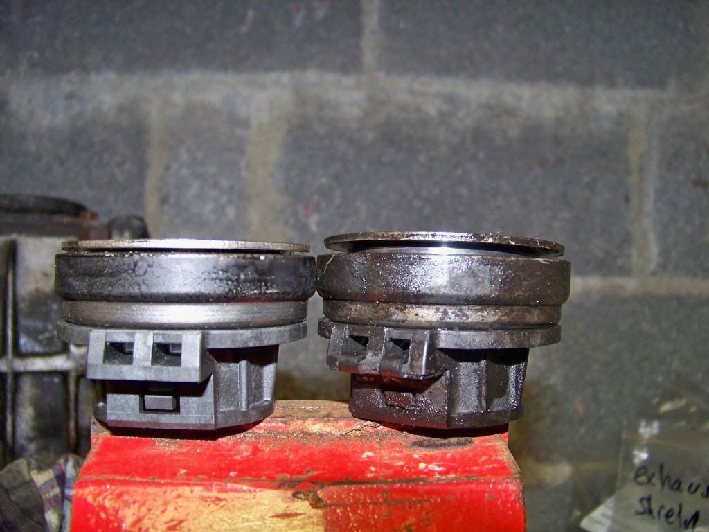

This is my first clutch job so I'm not sure if this is gone or not, sure looks it to me. I can lift it with little effort. The new one doesn't move.
The torque tube has me worried, I had a look at the parts catalogue and the bearings don't come separate. Meh!

Wouldn't worry about that. Just get one of the bearings out for the size/number. It'd be pretty much standard bearing stuff.Number 47 wrote:The torque tube has me worried, I had a look at the parts catalogue and the bearings don't come separate. Meh!
Are there 3 bearing inside or 2? They had both quantities at different times.
Re: Hello. (New member) I brought pics!
They arn'tmacplaxton wrote:It'd be pretty much standard bearing stuff.Number 47 wrote:The torque tube has me worried, I had a look at the parts catalogue and the bearings don't come separate. Meh!
Much like the B172k clutch shaft bearings, they are encased in a rubber substance. Getting them out isn't super easy either, try drifting and they move as far as the next one then seized solid. I've made a custom winding pulling thing and pull them out that way, but you need to make a piece that can drop through the centre hole then square up and seat behind the bearing.
Measure the distance they are in the tube too. I've no idea how critical it is, but every one I've seen has had the bearings in the same place.
