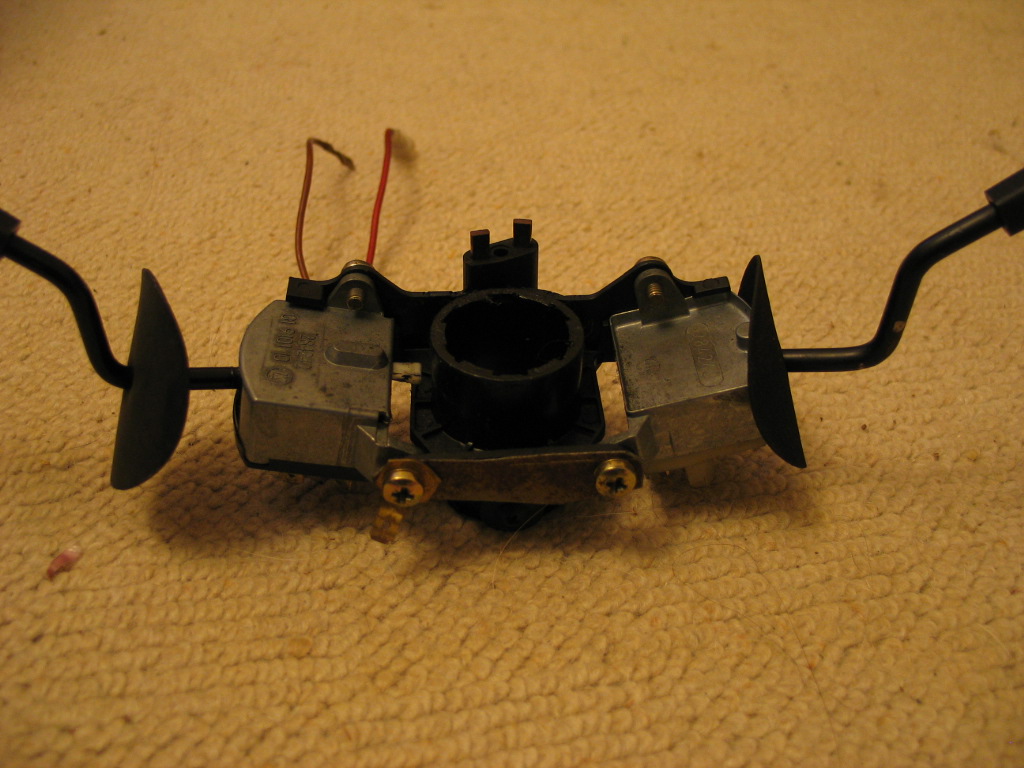

Yes, quite a common problem, use fingers for the stalks not hands!
Repair depends on the what the damage is, the left hand bottom screw hole (for the switch module) in the plastic collar is narrower then the right hand side and usually is the first thing to go. It can be repaired solidly with a piece of metal with 2 holes for the screws, preferably with the all the bits of plastic still there.
Here's one I repaired earlier!
