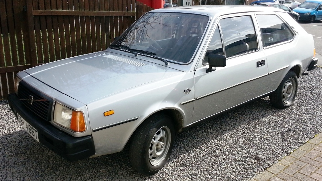

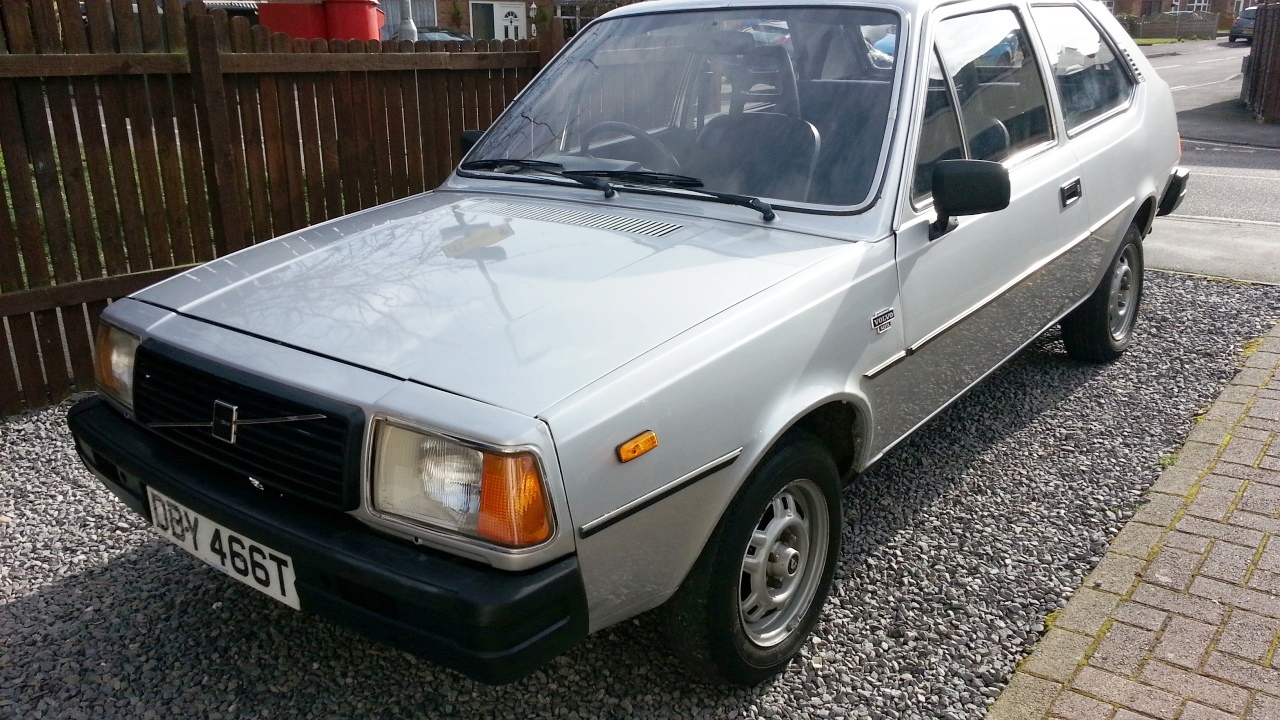

First T cut and polish!
Many thanks to you alll for the replies, I will do as suggested and put a drop of additive into super unleaded!
Anyone know where I can find a centre cap that matches for the wheel, It only has 3! :(
