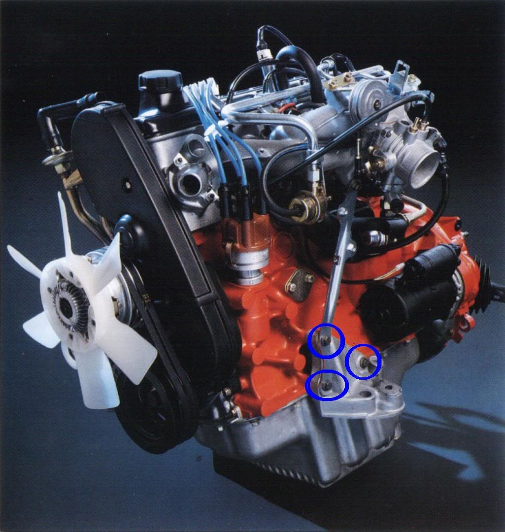

Post by RandomHero »
Damir130 wrote:don't know whether a custom engine mount will suffice..
The underblocks are all the same. So the holes for the engine mounts of the stock B200E are also on the turboblocks.
