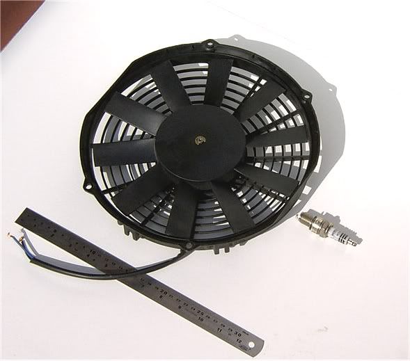

Hi Mac,
Sucker or blower? (Cue Redline with 'ooh err' comment...)
The problem the Kenlowe man highlighted is that I'll need something which can flow some serious 'cubes' if I'm going to keep a radiator/condensor/intercooler combo cool, especially given that the standard 360 AC combo will do a pretty good job of trying to make the car overheat. The unit he suggested was rated at over 20A, IIRC.
Any further specs on this fan?

Hi Mac,
Thanks for the further info. Sadly I need every mm I can get in front of the radiator for the condensor and intercooler, so the fan will have to go behind. Having said that, it's a nice spec (and higher flow than I expected) as either an aux fan for a 360 with AC (hint hint Andy!), or as a main fan if you could find a second one (or even on its own, to be fair).
Hi there redline, Yes you can reverse the polarity and hence direction of flow - BUT each blade of a well designed fan is in effect a little 'aircraft wing' which produces 'lift' as it passes through the air. As the fan is 'fixed' along the axis of movement the air has to move (hence the fan blows air). Reversing blade direction changes the aerofoil shape that is presented to the air (it would be like trying to fly an aircraft backwards) You will get flow ('lift') but much less efficiently (probably less than 50%).
Whilst the fan motor is quite happy to accept a reversed polarity, the blades are designed to turn in a specific direction.
(apologies if I'm 'teaching grandma to suck eggs')
All the best - Mac.
